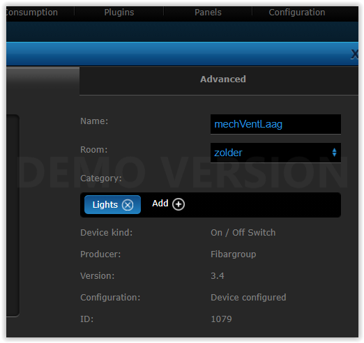

    Getting error (35) Item ID 'zoldermechVentLaag' not found in the system.
    here he is?? Whats the error?
    /monthly_2020_10/image.png.070fc2a4f255c5b07079b1a0736623f0.png" />
    hehe its a verry small error
    My keyboard give other signs
    ` shoiuld be
    ' getting
    16 minutes ago, Sjakie said:
    zoldermechVentLaag
    how it define in jS2n?
    Attached version has more CPU improvements.. now I have same CPU load with or without timeSlots.
    May I ask all users to review jM lines and to optimize as much as possible.
    Edited by cag014
    As it should bezoldermechVentLaag=1079,
    ' was in rule instead of  `
    ER is having ' so mistake of human behind keyboard(as useual)
    hehe 2 simple rules are now in.
    //Sjakie
