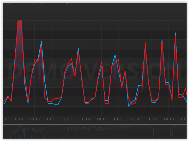

    What about CPU load... ?
    Could you please reboot HC3
    Here is the CPU screenshot and my RAM.
    I trying the reboot now again.
    Wow.... CPU and RAM are extremely high,
    I believe you're running latest Fibaro firmware 5.050.13
    Edited by cag014
    Yes. Allways. But I don'understand, why?
    After the reboot.
    That's unusual... and slows down HC3 performances (same as in HC2).
    I can do some "stupid"  workaround, but you should investigate why CPU so high. It will slow down other actions as well (no AOQ only)
    @Sjakiedid some investigation on CPU performances, maybe he can help!?
    You should look 3-5 minutes after reboot or start.
    HC3 and HC2 show in my case CPU sky high.

    12 minutes ago, SmartLifeSystems said:
    @Sjakie, can you help me?
    Thanks!
    2 minutes ago, cag014 said:
    May I ask you few questions:
    1. how long takes to save Lua/block  scene after change?
    2. Do you have scenes in loop? I mean run based not on device triggers (like on time interval)
    3. any QA devices in loop?
    4. how many Z-wave devices you have? Might be some device "bombarding" Z-wave traffic.
    5. Do you have Nice devices?
    Edited by cag014
    I think I need to convert Z-wave monitor for HC3 and to add Nice devices monitor.

    7 minutes ago, SmartLifeSystems said:
    Here is a screenshot. When turned off the AOQ, and when turned on.
    @Rover
    I think you have the most complicated AOQ, what about CPU load while AOQ running?
    Version 5.050.13 ?
    1 hour ago, cag014 said:
    @Rover
    Edited by Rover
