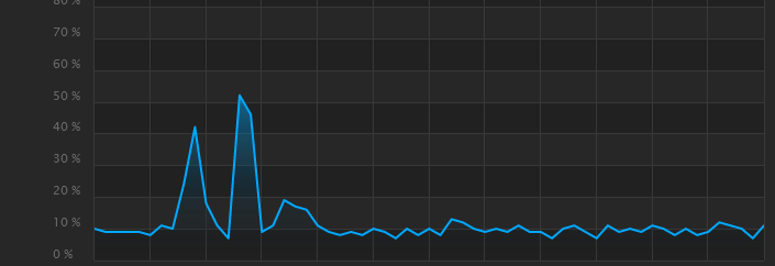

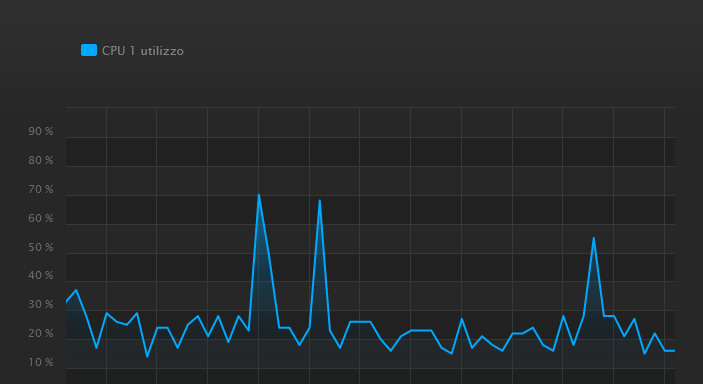

    aoq and 9 slaveswitches active ( polling time 1000)
    /monthly_2020_10/Screenshot_5.png.fa16eed408a6118fd64fbb92ca6566fe.png" />
    no aoq nor slaveswitches
    Only aoq and no slave switches
    You can increase the sampleRate to 2 sec. Sounds strange that API request overload CPU!?

    tnx but i think it's normal for hcl...in the past i moved every scene to hc2 cause with 3 or 4 scene active in hcl i had to reboot overy day. I use it just like a zwave repeater...

    to have a significant cpu load reduction 5secs it's the minimum...but it has no impatc on function, only state it's refreshed witha small late
