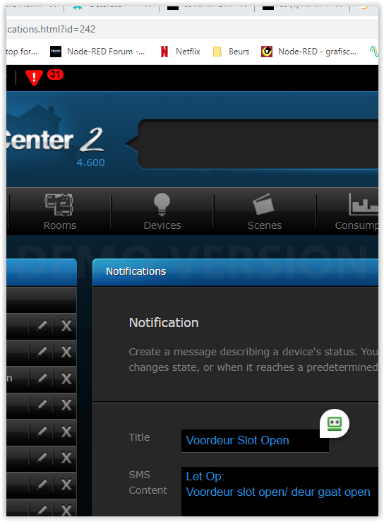

    Hello Jan,
    Some where you have posted:
    rule("373:secure") -- locks
      rule("373:unsecure") -- unlocks
      rule("373:lock") -- same as 373:secure
      rule("373:unlock") -- same as 373:unsecure
      rule("373:isSecure") -- true if locked
      rule("373:isUnsecure") -- true if unlocked
      rule("373:isLocked") -- same as 373:isSecure
      rule("373:isUnlocked") -- same as 373:isUnsecure
    Unfortuanaly they all doest work for me!
    I am on 4.60 and ER the greatest last  V3.0 build 89
    If I create a block scene they use the words opened and closed when I change  the view in LUA >>fibaro:getValue(1153, "secured")) == 0 ) Value 0 or 255
    When I create ER rule I need to use:
    Rule.eval([[hal.voorDeurSlot:isClosed => in real life lock is open or Rule.eval([[hal.voorDeurSlot:isOpen => in real life lock is Closed
    but its reversed???
    Please can you check? Or do I need to go to a medical institute?
    Please advice,
    //Sjakie
    App on phone shows close
    /monthly_2020_10/image.png.2b27a2ddf93d0ddada6dae07e324eeb1.png" />

    isOpen and isClose is normally used for things like roller shutters and test against the property 'value'.
    What happens if you instead use
    that test against property 'secured'
    Jan,
    doest work either.
    //Sjakie
    Can you help me figure out if
    fibaro:getValue(1153, "secured") == 0 means that the lock is closed/secured or if it's open/unsecured ?
    Open
     ( tonumber(fibaro:getValue(1153, "secured")) == 0 )
    closed
     ( tonumber(fibaro:getValue(1153, "secured")) == 255 )
    Manual lock, manual unlock, opend pin user all empty
    in docs is written unsecure but I cant find in Block scedule
    //Sjakie
    /monthly_2020_10/image.png.86e058d48c188d6118601a5768cae015.png" />

    17 hours ago, Sjakie said:
    Open
    closed
    //Sjakie
    Ok, it seems to be backwards. Usually '0' denotes "closed" and >0 that something is "open". I guess I assumed that secured was the same as closed.
    You still run ER3? I can release an update soon that switches the logic for :isSecure and: isUnsecure
