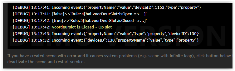

    Jan,
    Shoot me!
    Danalock device: V3
    Product firmware version: 0.16.0
    Smartphone model: IPhone11 pro ,Smartphone software version: 14.0.1
    HC2
    Lock  is OPEN!
    /monthly_2020_10/image.png.ff7c47c49ebd71538d201ed9e528a94c.png" />
    In phone app lock is also open
    In debug lock is Locked????
    ER version 3 build 90
    Secure and unsecure dot show in debug
    What is or I am doing wrong?
    Please advice,//Sjakie

    If you try isSecure2 and isUnsecure2 ?

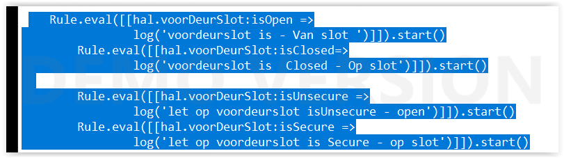

    Jan,
    These rules I have
    /monthly_2020_10/image.png.68437901bc9eba9d6f42a96f7ef5b684.png" />
    Secure and Unsecure just if they art present nothing in log!
    ER doest give any error
    //Sjakie
    Have you declared
    %% properties
    <danaId> secured
    in the header?
    Jan,
    You are the best.
    Two things due to HC2 cpu sky high I notest It doest safe the ER scene or he saves after an other modifying and he is one version behind.
    Need to solve that first for a better operation.
    Secured is working now all the others are giving a false view of the position of the lock. Secured correspondent also with the app.
