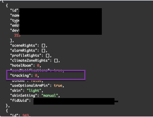

    48 minutes ago, ChristianSogaard said:
    Thank you Jan - Very Cool. -I will test ??
    I tried adding this in EV4 - first and second try gives this. any idea?
    Also I tried the swagger an there is a tracking thing per user. that is OFF
    I tried enabling the GEO fencing in the APP  - but it dont change this setting.
    Also - can you filter out the superuser here?
    /monthly_2021_01/2021-01-18_13-44-50.png.121de00ca9b85193701ac53b19675c64.png" />2021-01-18_13-43-37.png.4235366932d13df8da0741611078bacd.png
