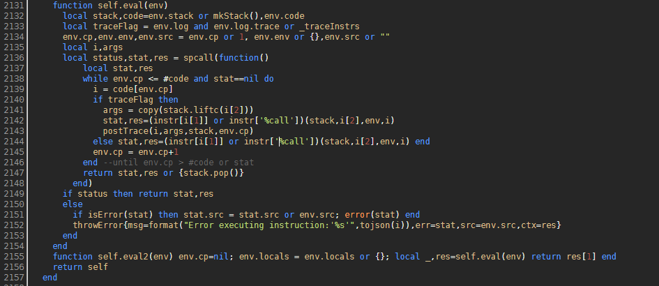

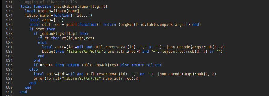

    Hello @jgab
    Found another error in my ER , could You look at it on free time , thanks
    Debug:
    This is VD 1053
    /monthly_2019_08/image.png.3a8e9b9160e02d77142f0be49abb9808.png" />
    ER 2144 line :
    ER 976 line :
    12 minutes ago, domin12 said:
    Hello @jgab
    Debug:
    Fixed in v3 B25. I'm a bit more strict what actions are allowed on deviceIDs and I take the actions from the deviceID structure where Fibaro lists available actions.
