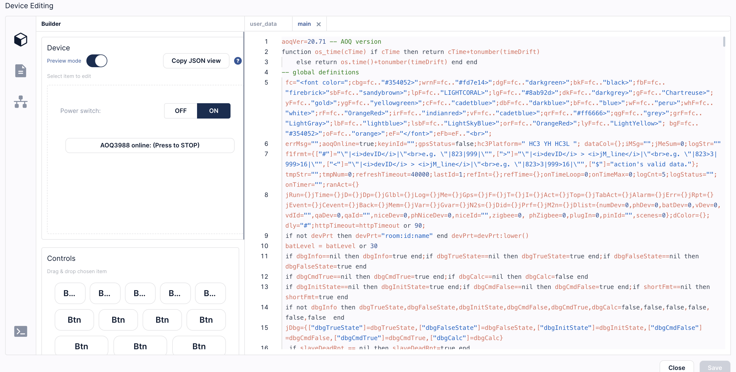

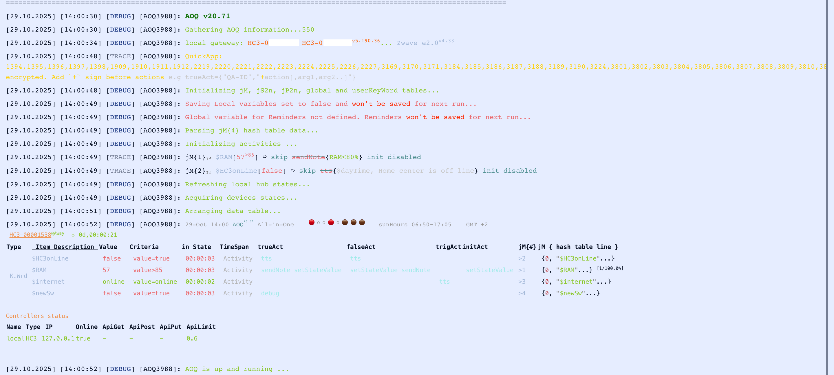

Dann
Hi Cag014,
After installing the latest ( 20.7 ) version, I got the below error message :
[26.10.2025] [11:45:01] [DEBUG] [AOQ3988]: AOQ v20.7
[26.10.2025] [11:45:01] [DEBUG] [AOQ3988]: Gathering AOQ information...550
[26.10.2025] [11:45:01] [DEBUG] [AOQ3988]: local gateway: HC3-0xxxxxxxxx HC3-0xxxxxxxxv5.190.36... Zwave e2.0v4.33
[26.10.2025] [11:45:07] [ERROR] [QUICKAPP3988]: QuickApp crashed
[26.10.2025] [11:45:07] [ERROR] [QUICKAPP3988]: main.lua:297: attempt to index a nil value
As you can see I am on HC3 v 5.190.36.
I inserted in my user_data, beside ( not instead ) of your default variables, some of mine ( solely on jS2n and jM ).
With or without those additions, I got the same message.
Can you help me to identify were should I change or modify ?
Looking forward to hear you back,
With best regards,
Dan
cag014
Looks like you have a very strange QuickApp.
Any idea what it can be? Did you add any QA lately?
Please try version below and let me know if it works.
AOQ-main-v20.71.txt
Edited by cag014

Thanks Cag014,
I see some progress here. See attached the response within console ( the screen-shot looks better instead of a copy/paste solution ).
On the other hand, I see nothing in the Device Preview ( regardless if " The new views in mobile application" is set On of Off ) . See attached as well.
Your help and effort is highelly appreciated and I continue to count on it ( as much as you can give me a hand ). Maybe it would be used by some other Fibaro users.
Looking forward to hear hyou back,

Now I can see that AOQ works for you, correct?
Dann
OK clear.
Correct. It works and I can see the details in the Console.
